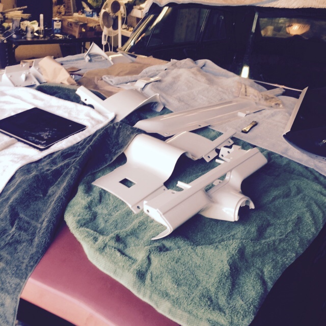

So like I mentioned: The interior of the car needs to be put together. We pulled out all of the dashboard parts for service earlier on. Instrument panel, radio, and clock have all been rebuilt. We cleaned up all of the metal, and had the painted surfaces re-painted. They weren't in bad shape, but with the way the seats were looking, we knew we had to spiff up the dash as well. But before the dash can be installed, we needed to clean up the steering column.
Steering column sanded, primed, and ready for paint. There was quite a bit of masking to do.
Steering column painted. My Dad masked, sanded, and primed the column, then went up to the auto restoration shop in our town that painted the dashboard. They mixed up a small jar of paint, and my Dad zipped back home to spray it on.

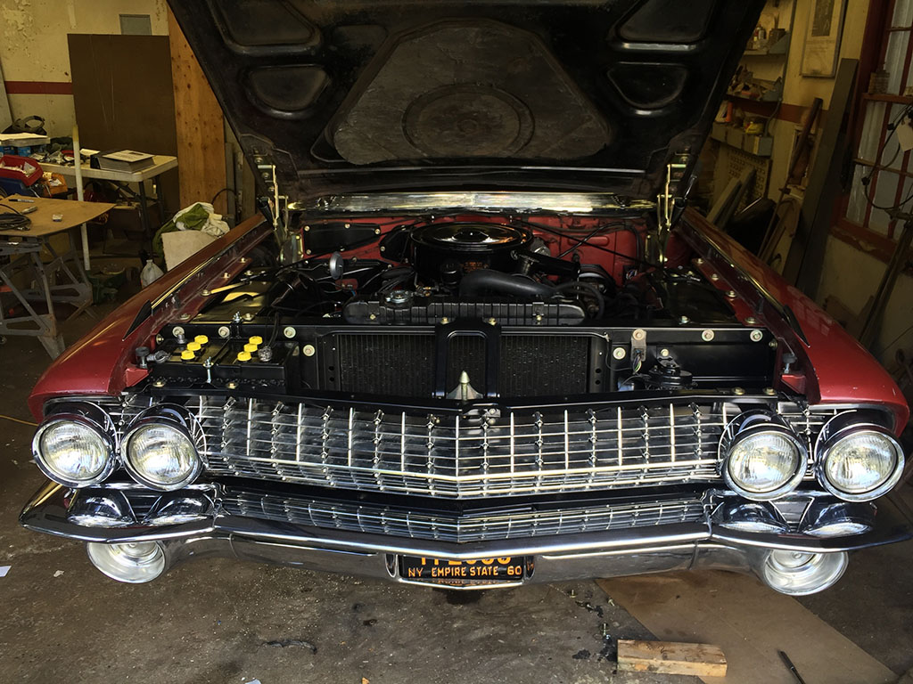

Christmas in July, folks! The front grill is installed.

Front end with the hood open.
Close up of the engine bay
And the hood closed. We put the chrome cowl in.
The starter is hooked up and works as well. You can turn the key and the starter will engage and the engine turns over. We don't have the coil plugged in so it won't spark right now. There are a couple of small leaks have appeared that we need to fix before trying to start and drive the car.
