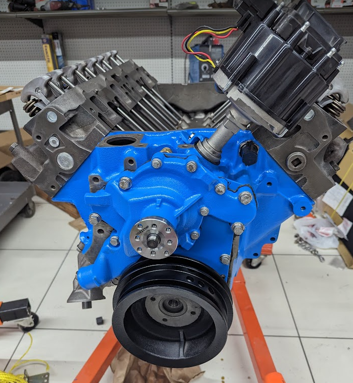

I installed the harmonic balancer tonight. Please confirm it appears to be fully seated. The oil slinger seems firmly jammed in place. The machine shop removed it, not me, so i don't know if the gap on the nose is normal.

Mine measured .31" from end of the crank. Some insight may be available on a face book site called Cadillac 472/500.

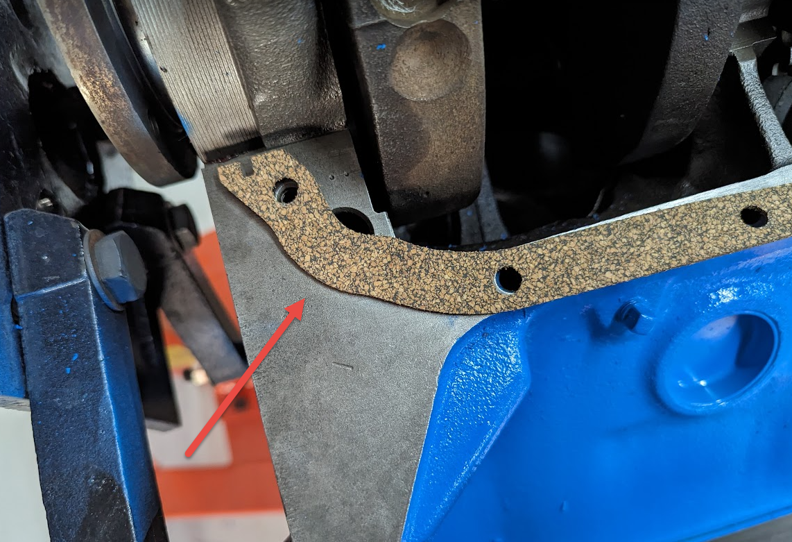

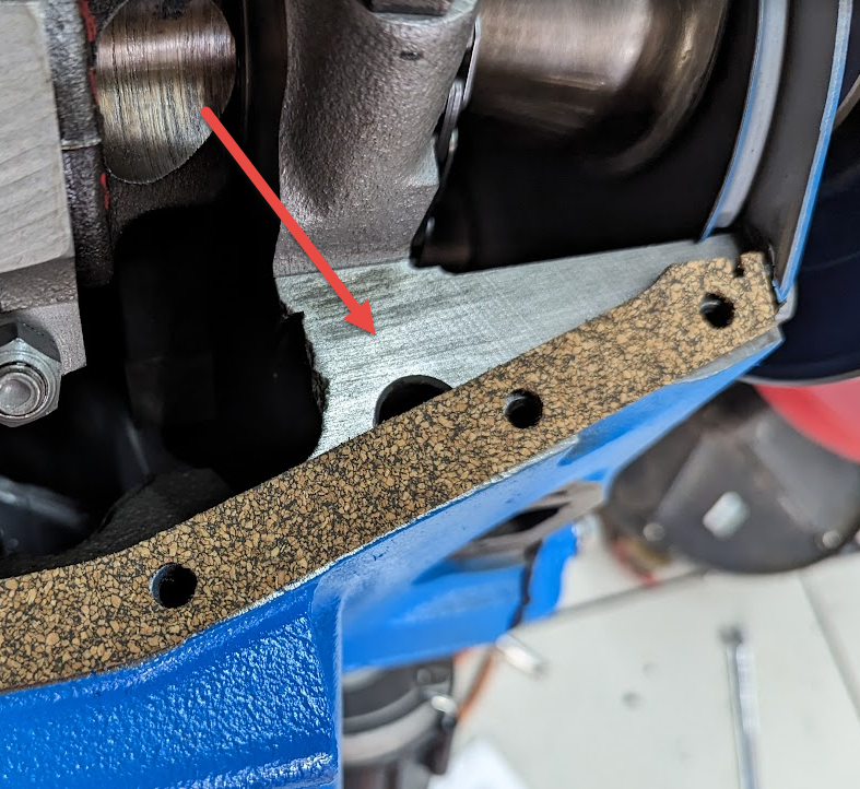

Those large block holes have me wondering if i have the correct gasket. Should I be concerned?

Those holes are normal.   As long as the gasket covers the outside of the holes, it will be good.
These holes could be there for machining locating, or allowing machining deeper into the block.

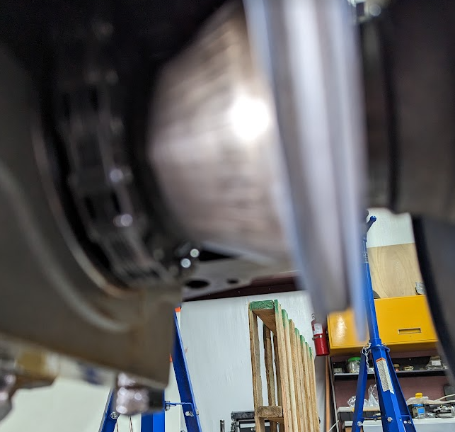

When i had the pan open and I was placing the gaskets the rear rubber seal seemed to only go in one way in order for the "keys" to match up to the cork gasket.  Now that it's installed I have a doubt if I got it right since there so much exposed.
Does anyone know for certain if i should pull the pan and reverse that rear rubber seal?
Thanks!

Looks to me like you have the neoprene seal back to front.
There shouldn't be that much poking out.
"Cadillac Kid" Greg Surfas 15364
The tabs are offset which makes it fit only one way.this appears correct.

scottsdaleaz
#31
Thanks all...  i searched in shop manual no detailed photos.  I see another youtube video and that seems to match my results.  I wonder if the exposed ribs help with some shielding when mounting up the transmission.
I also reached out to Fel Pro support.
I went back and did forensics on my earlier pictures. The shot below gives me "warm fuzzy"  the seal is in correct based on seeing the photo with the key location and the mating surfaces make sense for my results.
