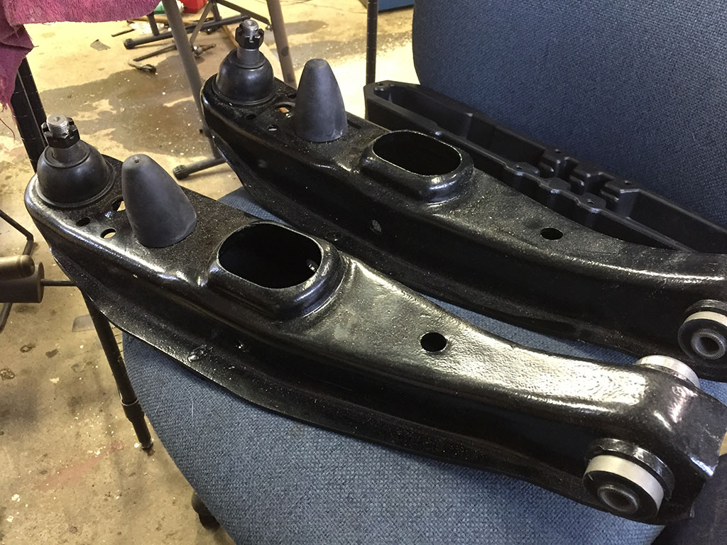

Assembled lower control arms from USA Parts Supply. We've got the bearing, ball joint, and frame bumper.
Assembled upper control arm from USA Parts Supply. We've got everything except for the frame bumper. So now we've got to get ahold of the customer service rep on Monday and get that straightened out.

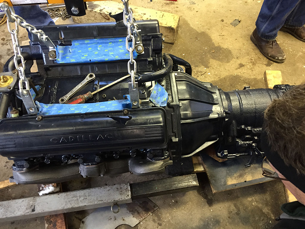

Engine and transmission went back into the car this weekend. We brought in some extra hands to help out: My brother and his father-in-law.
Transmission is being attached to the engine. We used some drifts to get bolt holes lined up.
Guiding the engine and transmission back into the garage. We have a two-bay garage, so engine work was happening in the empty bay, while the car is in the other bay. The ground was frozen, but the weight of the engine meant we had to use breaker bars and 2x4's to help the engine hoist along. You can see some of the drag marks in the dirt from the front caster.
We're in the bay, and my father's pointing out the holes for the engine mounts. We have a load leveler as well which was a huge help for this process. The adjusting handle was pointing towards the firewall, so when the engine was in it was tricky to adjust the angle. I'd highly recommend having the handle point out if you're doing it for the first time yourself. Also, the garage floor slopes into the center, so the hoist wanted to roll on us a lot once it was in the bay. It got a little exciting, but no one was hurt and nothing was damaged.
And we're in! Obviously a huge step, and allows us up to start putting the front end back together. Things should start moving a lot faster now.
