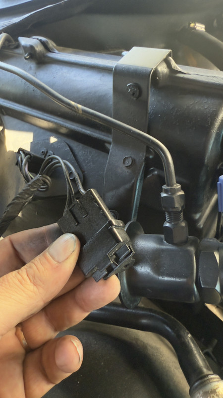

The A/C compressor clutch won't engage unless I power it directly. System has been rebuilt and charged, so refrigerant is fine. It does blow cold air when powered directly. Fuses are good. Without DEF selected ('72 model), I only get heat on the floor. What would be the first things you'd check?

Sounds like the Thermal Fuse on the Evaporator box could be blown.   This is designed to blow if the Compressor loses refrigerant, and the blown fuse saves the Compressor from self destruction.

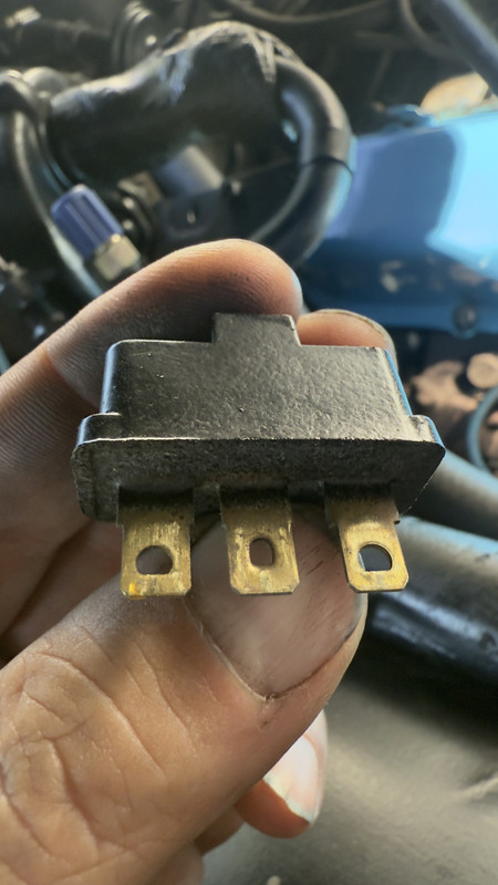

Plz C pictures
I tried to bypass it with no effect on coil,
Then I gave the center spade 12v and the blower motor relay clicked and fan started.

TJ Hopland
That is the thermal fuse. If you were gonna jump it you would jump B and C.   There is a small heating element between S and C (the outside terminals).  I don't recall the ohms but it should be a fairly low value like under 100 ohms.  If its good/not blown B and C should read zero ohms.
Power came in on B (middle terminal) from the control system and normally flowed out C to the clutch.  If the system was in distress a pressure switch grounded out and sent a ground to the S terminal.  Since the heating element was connected to C which had power it would begin to heat.  If it was on for long enough, I think minute to minutes? it would literally melt the fuse so power would no longer be being sent to the clutch (or the internal heating element).
It was basically a time delay circuit because during normal operation its normal to get pressure blips and you didn't want the compressor to cut out every time this happened.  With this delay it would only cut out when something was really wrong and at that point you needed a major service so after the repair was made, possibly just a recharge the tech would replace the fuse and you were good to go again.
