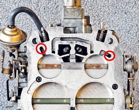

Can anyone tell me if the base plate of my Quadrajet is correct? (first picture).
There is absolutely no air bypass passage.
Usually the picture of a Quadrajet looks something like this:
(picture from here: http://www.crankshaftcoalition.com/wiki/How_to_rebuild_a_Rochester_Quadrajet_4MV_carburetor#Air_fuel_ratio)
In general:
What Quadrajet mods are needed for a 472 with MTS #5? Does anyone of you has an experience with this combo?
Thanks!

I don't believe the '69 quadrajet had idle bypass air, so I think your carburetor base plate is correct.
Although you can modify the carburetor to add idle bypass air, I think you probably can get it working as is.  I am not sure of the MTS #5 cam specs, but I don't think it has much overlap.  What source are you using for the vacuum advance?  Ported or manifold?  You will see a lot of disagreement on the internet, but you will get a more stable idle in and out of gear using ported vacuum.
With any non-stock cam, you are going to get less vacuum and therefore a weaker signal for the idle system.  This is typically why you need to add more idle fuel in these situations.  To increase idle fuel you can either enlarge the idle tube restriction or increase the idle down channel.  The idle bypass air helps to get the throttle angle in the right position relative to the transfer slot.  If the throttle blade is too high, you can increase the size of the bypass holes (or add bypass air in your case).
To start with, I would make sure the float is set correctly.  A higher float setting will get you more fuel everywhere (including idle).  I would also make sure that you are using ported vacuum.  More initial timing will also help a little.  Next, you need to figure out if the idle wants more air or fuel.  You can put your hand over the choke opening to check for a too lean idle (I like to use a heavy glove).  If the idle quality improves, you need to add idle fuel.  To check for a too rich idle, you can pull off a small vacuum hose.  If the idle improves, you need to add more idle air  (this assumes that the throttle blade is in the right spot already).  Let us know how that goes.
