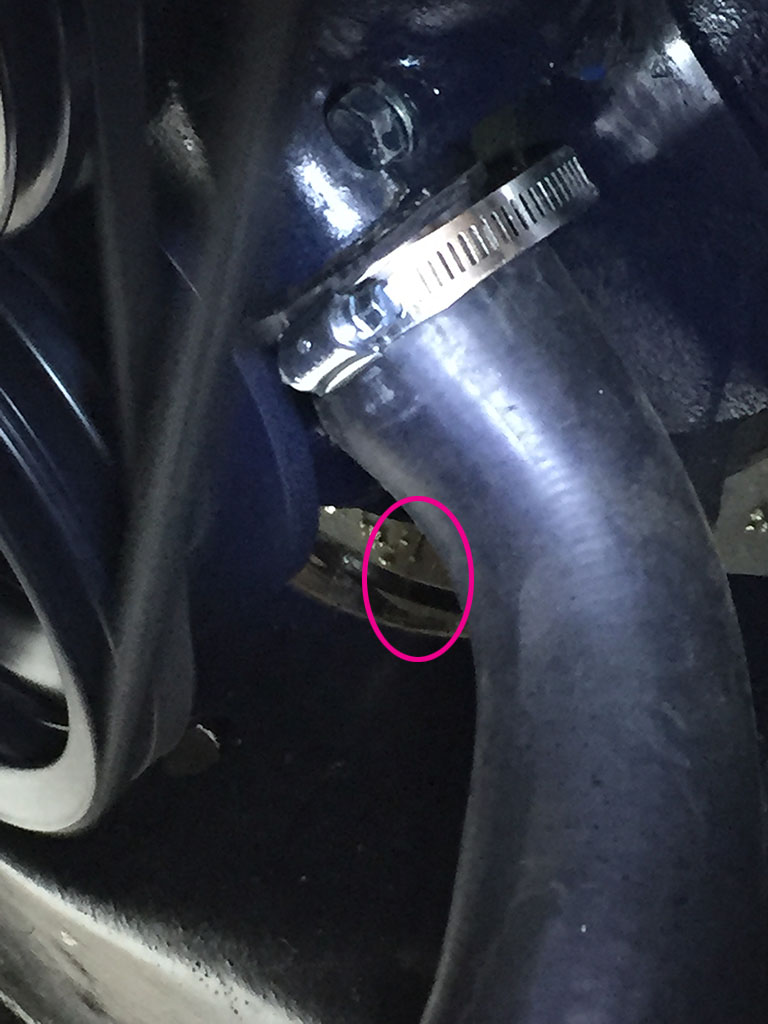

Assuming those hoses are the ones from Fusick, the lower radiator hose should be installed so that the markings are visible from underneath the car (unless they changed the placement of their stamp).  I would venture to guess that your lower hose is installed backwards.

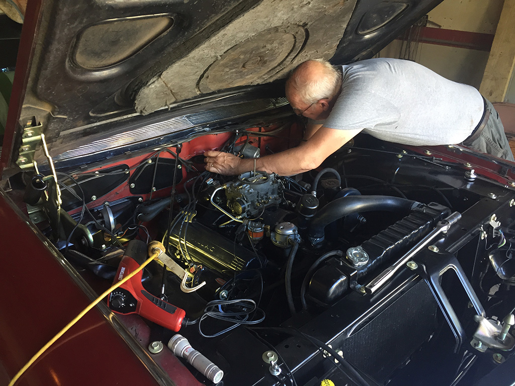

I talked to my Dad last night: it's running!
My Dad fussed with the timing some more and was able to get it dialed in better. Right now it's running for about 20 seconds and then quitting due to a fuel hose falling off or not having the vacuum advance hooked up to the distributor. But we're in the ballpark now.

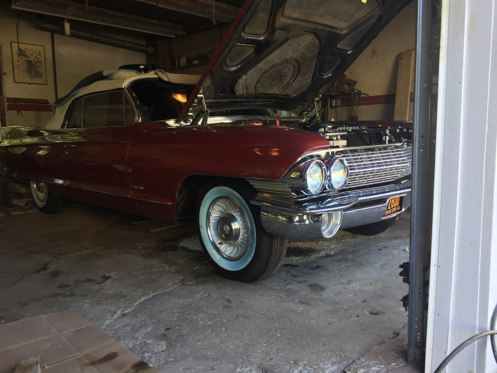

My Dad and I put the rear seat bench in, and the front seat as well for when we drive it to the body shop to have the carpet and remaining interior pieces installed.
My fiancée was out at the house as well, so I asked her to hop into the front seat with me for a quick photo. It was a little surreal for her as the Cadillac has always been in progress since we started dating.
Putting the driver's side tire on...
Back on four wheels (or tires) for the first time since late November 2011.
We're still fussing with the timing. My Dad bought a timing light, and also bought a wired starter motor trigger so we're both able to be looking at the engine while trying to start the car. My Dad was able to get it started on Friday, but Sunday we didn't have any luck. My Dad's going to call in some of his more mechanically inclined friends and see what they can do. We know it can start, it's just a matter of getting the car to start when we want it to start.

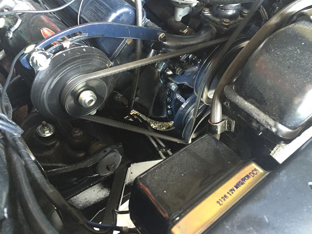

Andrew -
That fuel pump supply line is still on the wrong side of the fan belt and could easily br severed by the engine fan blades!
Jon

Andrew Trout
Quote from: Jon S on August 03, 2015, 09:04:29 AM
Andrew -
The gas that's in the tank is old. It's been in the tank for 4+ years, and we don't want to use it. For starting and testing purposes, we're running the old soft line from the pump to a small gas tank next to the radiator on the inside of the core support. It's clear of the fan blades.
The new soft line runs from the hard line up to the pump, and is held in place close to the engine block by the clips on the water pump bolts like you pointed out it should be.

Jon S
Quote from: Andrew Trout on August 03, 2015, 01:23:54 PM
Yup - Just making sure.  Continued Good luck with the project!

Andrew Trout

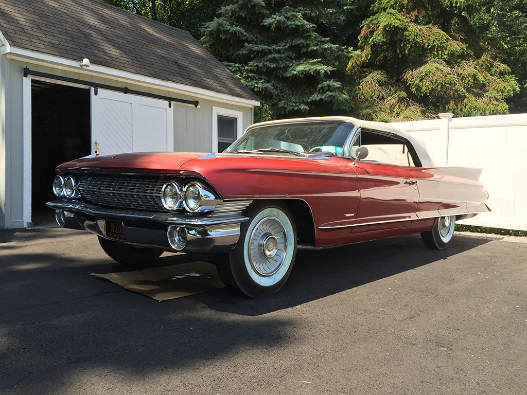

Well, it's been a few weeks. Between going to weddings, planning my own, plus my fiancée's bridal shower I haven't had any time to work on the Cadillac. Thankfully my Dad's been able to work on the car in the mean time.
This is where we are with timing. It's pretty damn close. The car starts up very easily, so at this point we're comfortable saying "close enough" and will take another look at in the fall. Between summer heat and engine heat it gets very hot in the engine bay.
On the downside, now that the car is running on it's own without issue, we've found an oil leak in the timing chain cover. The photo is horrible, but it's easiest to see when the engine is running. It's on the driver's side, either where the timing chain cover meets the oil pan or where the timing chain cover, oil pan, and engine block all meet. My Dad saw this earlier and pulled the radiator and water pump to get the timing chain cover off, and then replaced the gaskets and reinstalled it. Still leaks in the same place.
Any ideas on what's causing it? Do we need more gasket sealant or less? Are there any magic tricks to getting the cork strip that runs along the bottom of the timing chain cover to seal properly?
It's really frustrating as we can't drive the car in this condition, it will run out of oil in a matter of hours.
But, regardless of that, the car is ready to head to the interior shop tomorrow morning on a rollback.

savemy67
Hello Andrew,
Nice to see the car out of the garage - looks great!
I noticed in the photo that there is a piece of cardboard under the engine with a puddle of what looks like oil.  Is that oil from the leak?  If that much oil is pumped/leaks out of the engine, so that the car runs out of oil, it sounds like there is something mis-aligned, and that the gaskets are not seating where they should.  Try probing the area with a paper clip to see if you can find a gap between the mating surfaces of the front cover, oil pan, and block.  Another item to check is whether your gasket set included the correct gaskets for these areas.
These multiple gasket joins can be a problem, but try to avoid using too much RTV in the event you have to resort to the "gasket in a tube".

Andrew Trout
Yes, we've got an oil leak around the timing chain cover. Not sure exactly where though. Good idea on using the paper clip. Do you straighten it out and drag the tip of the metal along the edge until you find a hole?

Dan LeBlanc
Also check the condition of the shaft on the harmonic balancer where it goes in through the cover.  If it is badly worn, you can get a leak there also even with a new seal.
I believe to remove and replace the front cover correctly, the oil pan must be dropped also.

savemy67
Hello Andrew,
I speculate that if you are losing enough oil so that the car runs out of oil in a few hours, you have a really big gap at a gasket mating surface, such that the oil leaking out should be visible.  The paper clip would confirm that there is a sizable gap in the gasket/mating surface (the paper clip can be straight or bent depending upon how easy it is to access the suspected area).  Also, if that much oil is coming out of the engine, it may be being pumped out, so it is important to try to find exactly where the oil is leaking.
As Dan mentioned, if the shaft on the balancer is worn, the front seal wont be effective.  However, if the leak was at that location, oil would be slung around the front of the engine bay due to the rotating balancer, which, if I understand your problem description correctly, is not the case.
Both the oil pan and the front cover are steel stampings.  Depending on what service was done to the engine over the last 54 years, the mounting bolts may have been overtightened, and or the stampings may have been deformed.  With such a big leak, I would probably drop the pan and remove the front cover and make sure the mounting surfaces are true, and that none of the bolt holes have been dimpled.  Any dimpling can be reversed by carefully using a large ball bearing and a socket, or a small ball-pien hammer and a socket to dimple the bolt hole in the opposite direction.   ....almost there....
By the way, you and your fiancee make a cute couple.

James Landi
Have you noticed any engine paint overspray on gasketed surfaces.  Incredible as it sounds, this condition can cause engine oil leaks even if the paint appears to be well adhered to the metal
I would be pulling the sump to see where the problem is.
These engines don't leak when using the proper gaskets, and using the proper procedure to fit them.
To do the job properly, I would suggest pulling the engine and put it on the engine stand where you can work on it and really see what is going on as you are pulling it apart.
Sounds like the front seal is not seated correctly.
