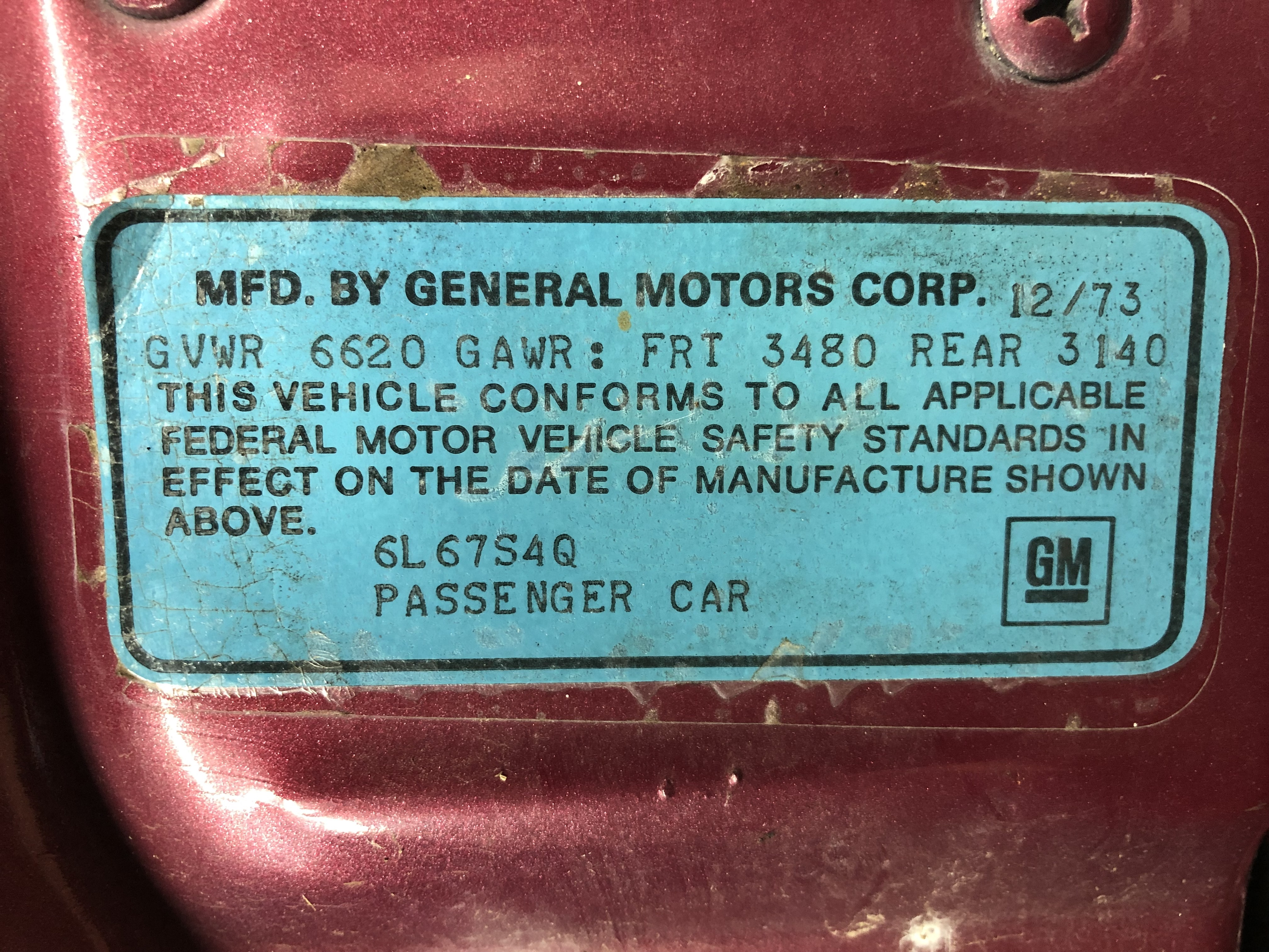

MaR, can you snap me a picture of your doorjamb stickers?  Mine were stripped by the painters, and I'd like to source replacements.

MaR
Quote from: hornetball on October 14, 2019, 11:55:02 AM
No problem, I'll take them in the next few days.

MaR
Here is the sticker:
Here is a full resolution version: http://jelloslug.com/caddy/IMG_6334%20-%20full%20size.JPG
As you can see, the actual vehicle information was added to the sticker after the boiler plate info was printed on and is in a different (typewritten) font. The sticker itself measures 3-3/4" x 1-5/8" and has a clear plastic laminating layer over the paper sticker.
