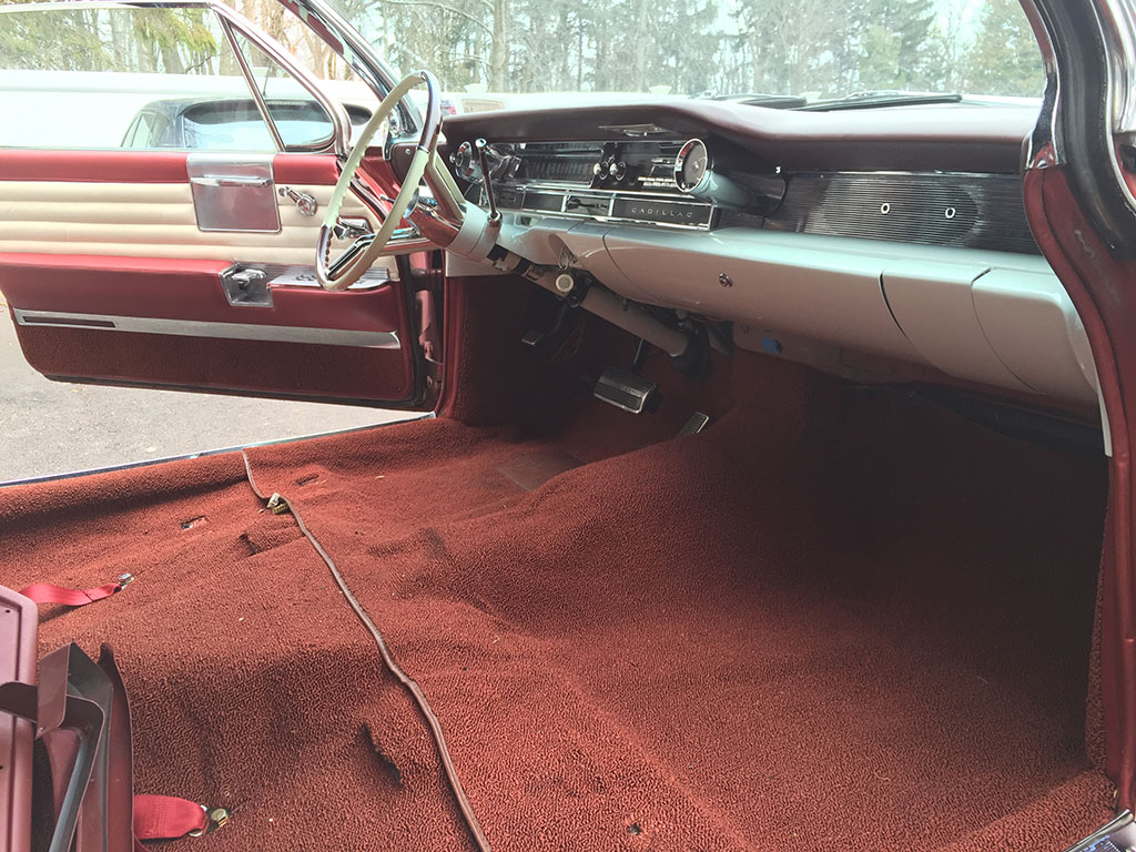

Interior is almost done. Car will be ready to pick up on Friday, but we're having them hold it until Monday and then getting it rollbacked to our mechanic's for some final work.
To better explain what 'interior is almost done' means:
• Dashboard was removed and re-painted
• Front and rear seat removed and stripped down to the frame, which was powder coated. Seats were then re-upholstered with new leather, foam and burlap.
• Door panels were removed and re-finished with new leather and carpet put on
• Kick panels removed, new carpet for them, the vents were removed and re-painted
• All the metal trim on the front seat was re-painted
• Armrests for rear seat were removed and re-upholstered
• sound/heat insulation was installed on floor pan
• new carpet
• new door sills
• Seats re-installed
• Door panels re-installed
• Rear arm rests re-installed
We went to http://www.carlsautoseatcover.com in Rochester.

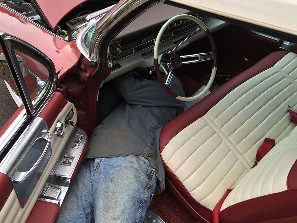

Working on the little bugs now.
First one was the horn.
We're still not sure where the horn is failing. It's a little frustrating. The horns sound if you manually engage them, but there some wiring somewhere between the button and the firewall that's not working. And we have no idea what it is.

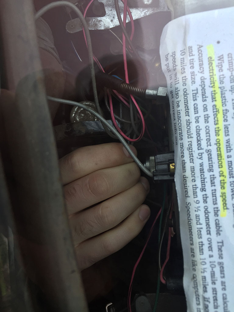

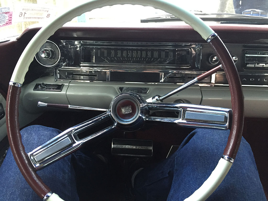

Next up was fixing the speedometer. Transmission was rebuilt, new cable, and the instrument cluster was gone through by McVey's. So all parts should be working. But nothing was happening when we drove. We thought maybe the transmission shop forgot to re-install the gear in the transmission. Or we needed to pull the cable off and grease the connection. When we were under the dash checking horn wiring, my Dad noticed we didn't plug the speedometer cable into the instrument cluster.
Whoops!
So, threaded that on and took the car for a spin. Speedometer works, along with odometer and trip odometer! We'll take it out on a highway to check accuracy against some mile markers later.

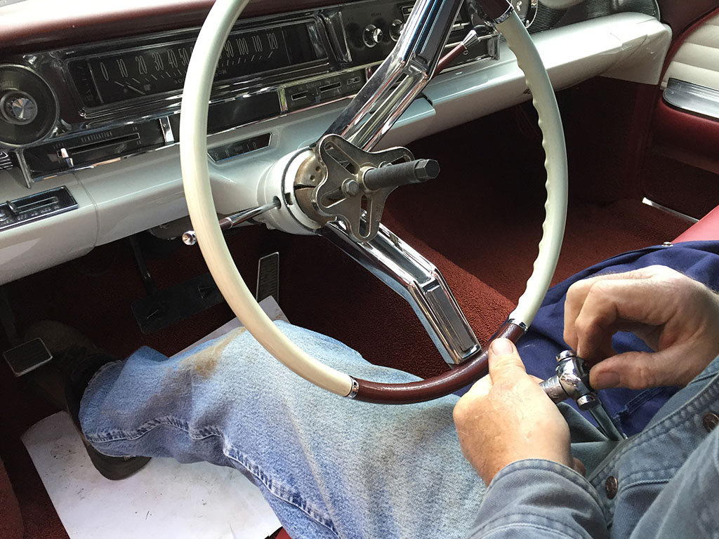

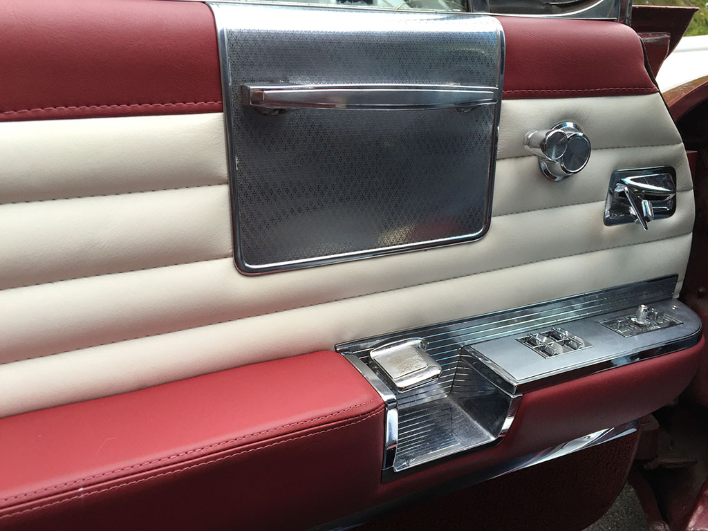

After that, it was time to fix the steering wheel. Basically it squeaked when you turned the wheel. My Dad was thinking we had it on too tight (or too close to the steering column) so there was friction when we turned the wheel. It also made the steering a little tougher at low idle. So we pulled the wheel off three times (once it wasn't straight). On the third pulling we noticed that if you didn't crank on the screws holding the center trim into place the wheel didn't squeak. Just snugging them up is good.
While we had the wheel off we checked the canceling spring as that's not working either. Everything appears to be in good order, and you see it move when you engage the directional. But the directionals won't cancel after you turn.

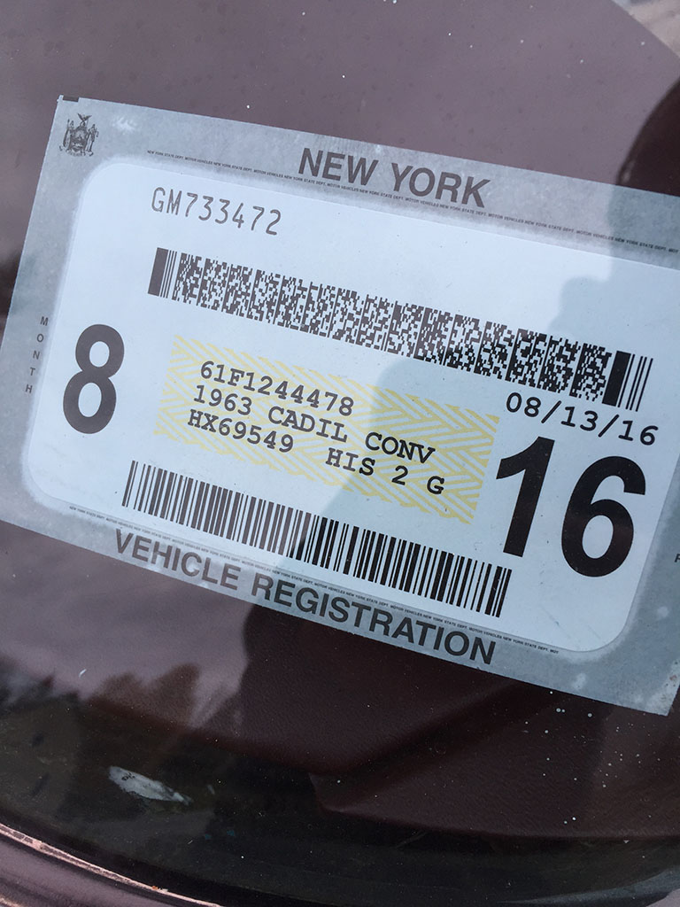

I also noticed that the great state of New York gave us the wrong registration. Sigh. It's frustrating because my Dad had the old registration with him. All they had to do was copy the date.
Driver's side door interior.

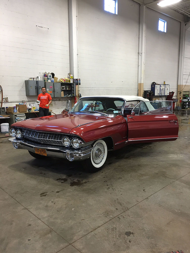

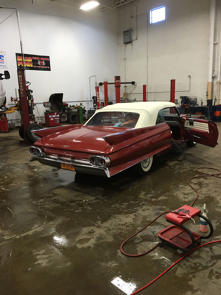

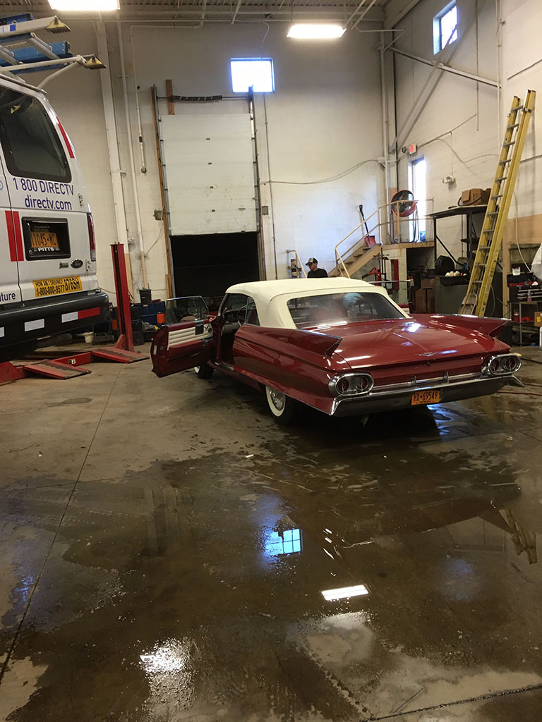

The Cadillac went through another round of detailing.
The first time, my Dad went to a friend who's done body work for us in the past. The guy used to do really great work, but has gotten a lot older and his worked has fallen into the 'eh' category. Looking over the Cadillac you could see spots that weren't as well done as others.
So, asked around town and found a new shop and man did they do a great job.
They clayed the paint, along with washed and waxed. No swirls from the wax, either! The shop also polished the chrome and stainless trim, cleaned all of the windows (including the rear window on the top), and I believe cleaned the top as well. They were also able to adjust the brakes and fixed the horn. Apparently our horn relay was bad. I would have sworn we replaced it earlier this summer. Oh well. Now the car has passed it's NYS safety inspection and is road legal...just in time to hibernate for the winter.  ::)
On the plus side, now that the car is legal, we're able to drive it to the transmission shop and have them find the small leak we're dealing with there, and then go to the interior shop to fix the front seat. The stitching is tearing on the bottom part near your hip, where the seat folds over it to access the rear seat.

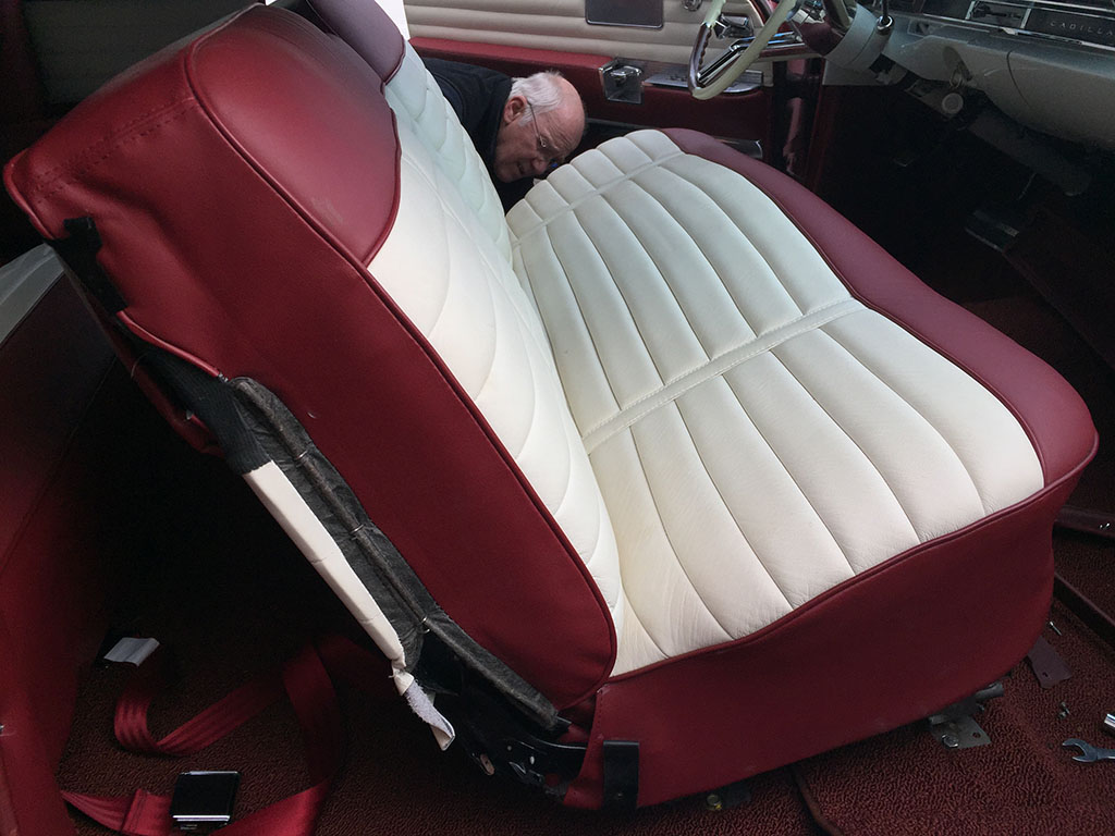

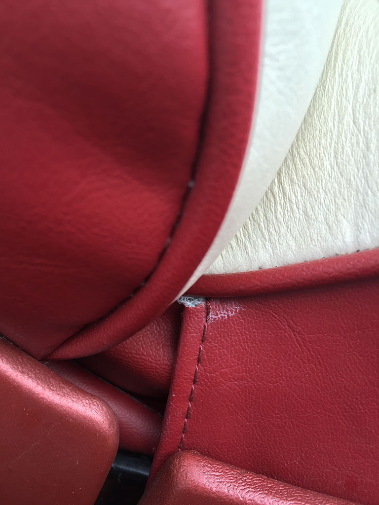

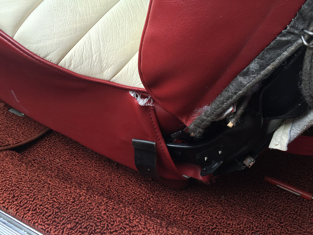

So the weather has been unseasonably warm up here, and my Dad and I opted to take advantage of it.

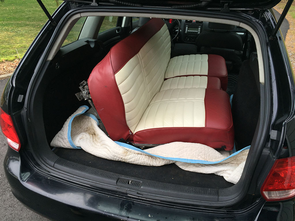

The seat leather has been ripping, and needs to go back to the interior shop for repairs and altering how the leather is sewed on so it won't rip in the future. We pulled the car out to have lots of room for removing the seat, but before that, we went on a quick trip.
My Dad driving the car.
We stopped at a gas station down the road that has ethanol-free gas (at over $3.00/gallon) and while we were filling up a guy at one of the other pumps came over to say hello. He was really impressed by the car, and at one pointed remarked "Hey, this is like...a show car! Do you take it to any shows!?"  Well, not yet.  ;D Next year we'll be doing quite a bit more.
I got to drive the car as well, and we just drove around the neighborhood. Lots of fun.
Then it was time to pull the seats.
You can see the rips in the seats. The drivers side is a bit worse, and both sides will continue to get worse.
We removed all of the trim from the seat before unbolting it. Unbolting was a pain, as it seems the interior shop used some sort of compound on the seat bolt threads so they're weather-tight. It make removing the bolts a real pain.
We walked the seat out, and put it in the back of my Dad's car. He's taking it over today (Monday) and they'll 'babysit' it for a while, meaning they'll get to it when they get to it. Fine by us, as we've got plenty of interior work to do this winter to get the dash pieces better aligned, and get the top to come down.
Here's the interior without the front seat. The dash under the radio needs some straightening, as do the ash trays. We're also going to take the section of the dash that says "CADILLAC" out and get that re-painted, and attached the medallion to the radio bezel. Also, the panel that goes under the steering column will get installed after we get the gear indicator on the shifter better adjusted (it's still a little off). Plenty of little things to work on after the new year.

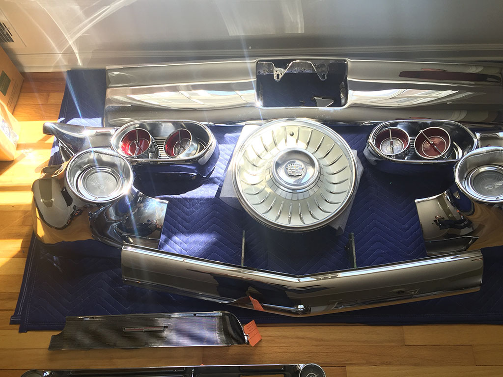

We bought some NOS parts this weekend.
While looking around on eBay, my Dad spotted some nice looking white wheel covers. Ours are in fair shape, but not as good as the ones listed. We shot the seller a note and he put the four best ones he had together and sent us a few pictures. We agreed to buy them, and asked if he had any other parts.
Turns out the seller is Tom Murray of the Valley Forge CLC Chapter and he has a LOT of parts. We drove down yesterday to meet him and buy what we could. It was a long day. We left at 5am and go back at 6:30 pm. But it was well worth it! We got the parts listed below
Four wheel covers
Complete triple-plated rear bumper and lights
Interior instrument cluster and radio trim with clock
Passenger speaker bezel and medallion
Hood medallion (no V though)
Brake shoes
Engine mounts
Three tail fin lights, two covers, and one NOS cover
NOS PF7C filter
Most of a front bumper. Lower parking lights and upper center part are re-chromed, the upper sections below the headlamps will need to be re-chromed
Some other trim parts
We also got to see Tom's collection of cars, and spare parts. It's extensive.
We'll be replacing some of our current bumpers and interior trim with these newly purchased parts and getting the original parts cleaned up. This way we can have a better looking car this summer and not have to deal with the frustrations of having an incomplete car at any point.
